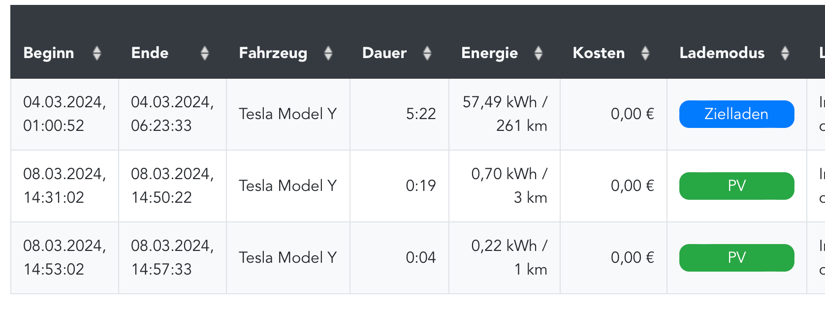

Ich habe leider immer noch keine Preise im Ladeprotokoll:
..und dazu noch immer diese Fehlermeldungen im Log:

Das Chargelog zeigt:
2024-03-08 14:50:22,760 - Fehler beim Berechnen der Ladekosten für Ladepunkt 4
  File "/var/www/html/openWB/packages/control/chargelog/chargelog.py", line 331, in calculate_charge_cost
    log.debug(f'power source {energy_source_entry["energy_source"]}')
KeyError: 'energy_source'
2024-03-08 14:57:33,051 - reference ReferenceTime.END, reference_time 1709902860, cp.data.set.log.imported_since_mode_switch 222.90000000037253, cp.data.set.log.timestamp_start_charging 1709905982.078927
2024-03-08 14:57:33,052 - energy_source_entry {'timestamp': 1709902801, 'date': '14:00', 'cp': {'cp4': {'imported': 3190972.9, 'exported': 0, 'energy_imported': 0.926, 'energy_exported': 0.0}, 'all': {'imported': 3190972.9, 'exported': 0, 'energy_imported': 0.916, 'energy_exported': 0.0}}, 'ev': {'ev0': {'soc': 0}, 'ev1': {'soc': 38}, 'ev4': {'soc': None}}, 'counter': {'counter0': {'imported': 3817374.7330392865, 'exported': None, 'grid': True}}, 'pv': {'all': {'exported': 30481671.421, 'energy_imported': 0.0, 'energy_exported': 4.83}, 'pv1': {'exported': 28171964.39, 'energy_imported': 0.0, 'energy_exported': 3.41}, 'pv3': {'exported': 2309707.031, 'energy_imported': 0.0, 'energy_exported': 1.421}}, 'bat': {'all': {'imported': 937494.39, 'exported': 882938.0, 'soc': 95, 'energy_imported': 0.0, 'energy_exported': 0.045}, 'bat2': {'imported': 937494.39, 'exported': 882938.0, 'soc': 95, 'energy_imported': 0.0, 'energy_exported': 0.045}}, 'sh': {}, 'hc': {'all': {'imported': 4224311.758808806, 'energy_imported': 2.339, 'energy_exported': 0.0}}}
2024-03-08 14:57:33,053 - Fehler beim Berechnen der Ladekosten für Ladepunkt 4
2024-03-08 14:57:33,067 - Neuer Ladelog-Eintrag: {'chargepoint': {'id': 4, 'name': 'Interne openWB'}, 'vehicle': {'id': 1, 'name': 'Tesla Model Y', 'chargemode': 'pv_charging', 'prio': False, 'rfid': None}, 'time': {'begin': '03/08/2024, 14:53:02', 'end': '03/08/2024, 14:57:33', 'time_charged': '0:04'}, 'data': {'range_charged': 1.01, 'imported_since_mode_switch': 222.9, 'imported_since_plugged': 222.9, 'power': 0.83, 'costs': 0}}
2024-03-08 14:58:11,841 - imported_at_plugtime 3191898.93
2024-03-08 14:58:11,843 - imported_at_mode_switch 3191898.93
meine main.log ist im Anhang. Darin ist ein Ladevorgang ab 14:50 mit DEBUG Loglevel.
Ich habe Tibber als dynamischen Stromtarif konfiguriert. Mir werden überall die korrekten Preise angezeigt. Auch die Vorschau für die nächsten Stunden im Status ist korrekt. Lediglich die Berechnung des tatsächlichen Preises scheint nicht zu funktionieren.
Ich komme vom letzten Release und habe den Fehler seit der 2.1.3 Beta 1. Dazwischen war ich nicht auf dem Master und auch nicht im Tibber Branch unterwegs.
Hat denn jemand noch das gleiche Problem? Oder funktioniert das bei allen anderen?
Vielleicht liegt es auch lokal an einer (zerschossenen?) Konfiguration, dann würde ich die OpenWB evtl. bald mal resetten und alles from scratch neu einstellen - auch wenn das echt viel Arbeit ist. Restore von einem Backup hat jedenfalls nichts gebracht.
PS: Ich musste den aktuellen Master installieren. In der Beta-Branch scheint diese Version aktuell noch nicht enthalten zu sein.

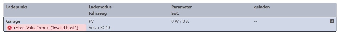

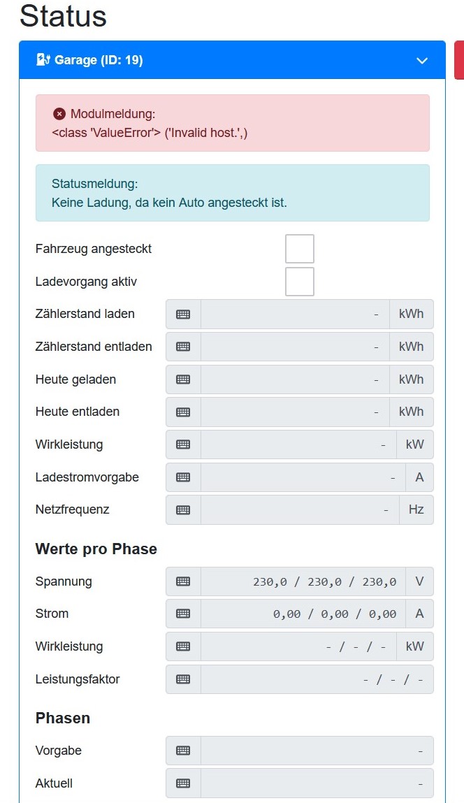

Ich habe auf meinem Testsystem Probleme mit dem Ladepunkt festgestellt. Alternativ habe ich den Branch und Tag für das Realese und den Master probiert, aber keine Änderungen.
Das ganze äußert sich in der Übersicht so, dass eine Modulmeldung "<class 'ValueError'> ('Invalid host.',)" angezeigt wird:
Und im Status sind keine Werte zu sehen:
Ich hab den Ladepunkt auch schon mehrmals komplett gelöscht, danach ohne eingetragenen Ladepunkt nochmal mal den "Brunch und Tag" gewechselt, damit natürlich auch immer ein Reboot des Systems. Im Anschluss habe ich den Ladepunkt neu eingerichtet, aber die Fehlermeldung ist hartnäckig und kommt immer wieder.

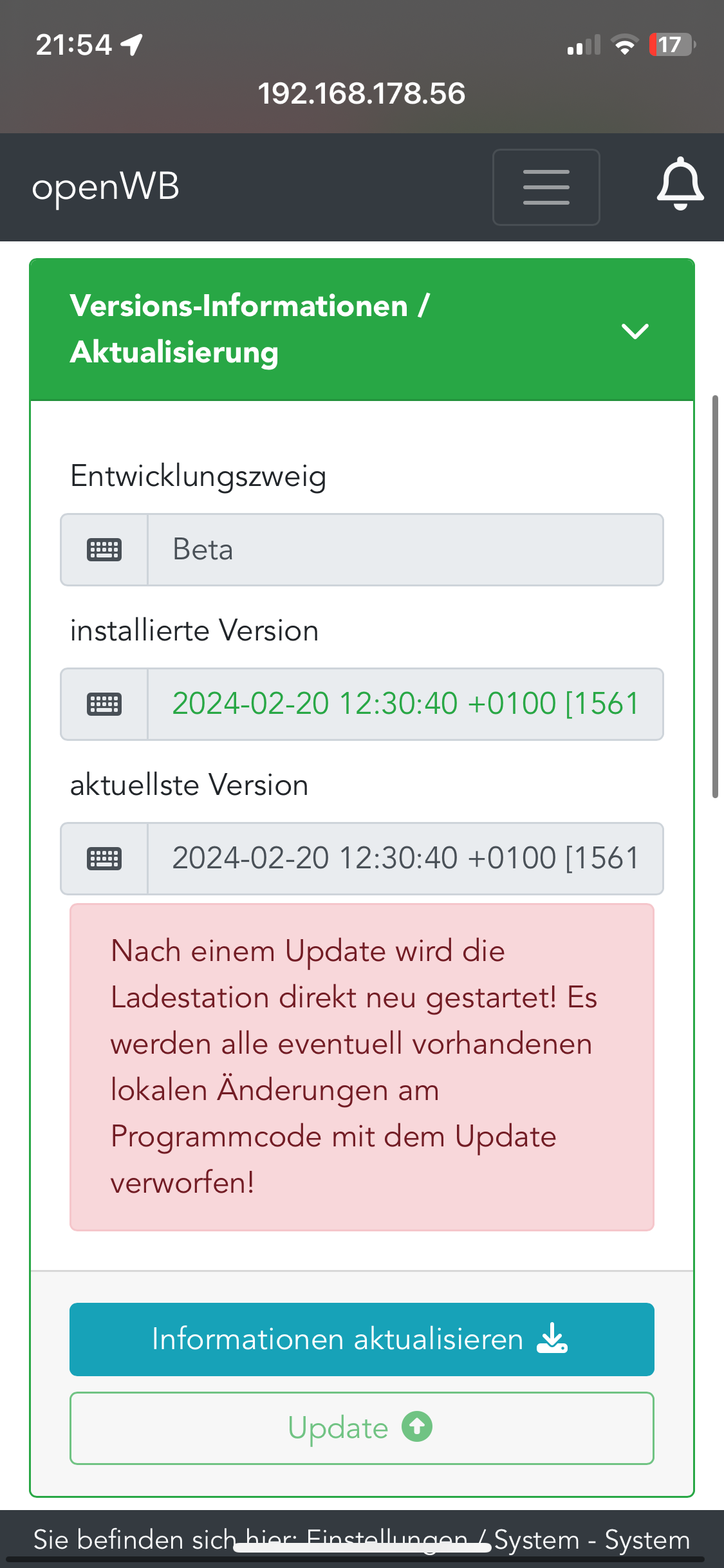

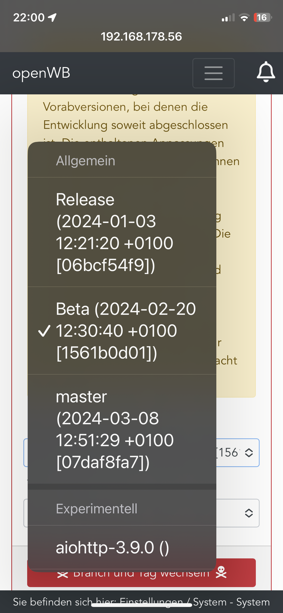

Die Nomenklatur der Versionen verstehe ich nicht: Hier ist von Beta 2.1.3 Vera 3 die Rede, in der Box finde ich aber Versionen mit Datum. Wie kann man das Nachvollziehen?
In der Box wird mir die Beta vom 20.02.24 als neueste angezeigt. Der Beitrag von @LenaK deutet für mich aber auf eine neue Version hin, die gestern veröffentlicht wurde. Vermutlich irre ich mich, aber kann mir jemand sagen wie das zu verstehen ist? :oops:
Beiträge: 9016
Has thanked: 251 times
Been thanked: 272 times
Re: Rückmeldungen openWb software 2.1.3 Beta 3
Schau unter System -> System -> Versionsinfo/Aktualisierung nach:
Deinem eingestellten Entwicklungszweig und aktuellste Version.
Datum gibt's auch dazu.

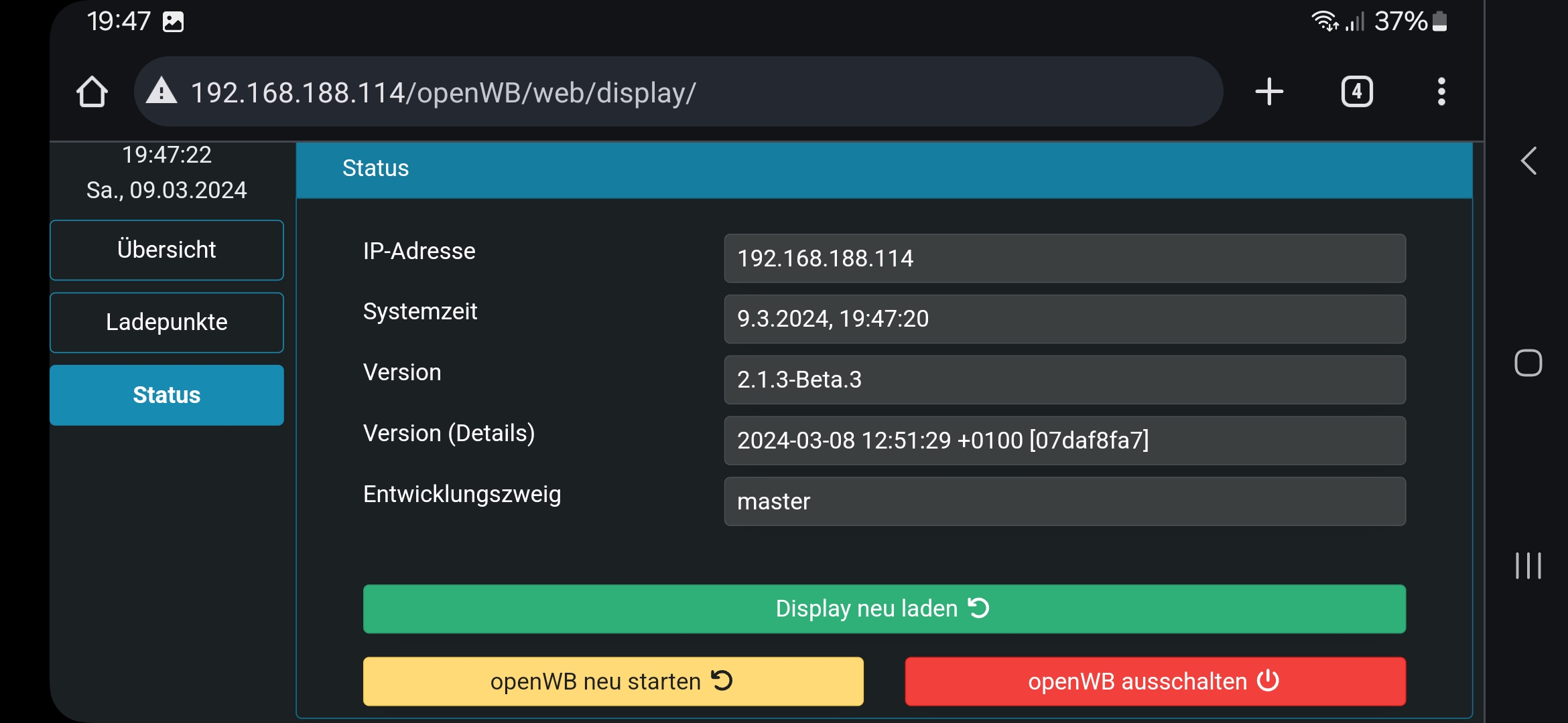

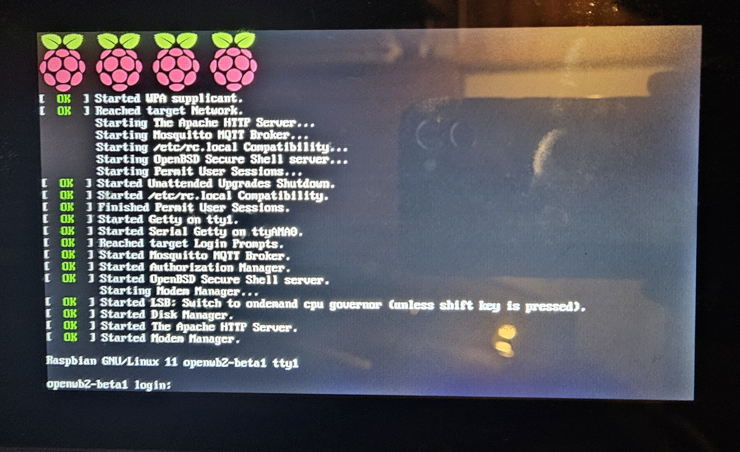

Seit dem Update auf der neuesten Version zeigt das interne Display der OpenWB nur noch Raspberrys und Schrift an :)
Aufruf über Web ist kein Problem.
Neustart bringt leider nichts.

Genau da hatte ich geguckt und weder oben auf der Seite bei der Version, noch unten bei der Auswahl des Entwicklunszweigs sehe ich die Versionsinformationen „
2.1.3 Beta 3“, sondern nur ein Datum.
Was übersehe ich?

Es interessiert immer nur:
master, beta, release
und
Datum
Der Rest ist schmückendes Beiwerk.
Ich turne hier auf irgendeiner alpha herum, die permanent upgedatet wird und somit aktuell ist.
